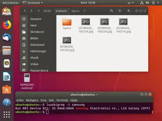

Connect to a Samsung Android phone via USB in Ubuntu 18.04 LTS
It works for me to see the Android via USB in Ubuntu 18.04 LTS, after
  • connecting the Android device (a Samsung mobile phone)
  • logging into Android and allowing the computer to see it. I am prompted with a question about it directly after logging in. (I use Android 7.1.1, and you may have to look for a menu item to allow the computer to see it in older versions of Android.)
  • Now the file browser nautilus in Ubuntu 18.04 LTS can browse the content of the mobile phone.
  • lsusb can also list it.
See the attached screenshot
