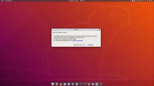

I have a HP 3630 all in one printer/scanner and it was working great on Ubuntu 16.04 with the HP Print manager. Now I did a clean and fresh install Ubuntu 18.04 and the printing work fine, but example Sane (or other scan software) can't find the device.
error message
I have installed hplip 3.18.4 that I found on the HP website, but still nothing. Even to add a printer in the HP manager didn't work. In the WiFi I tried the WIFI-direct to connect with the printer and that works fine also, but the scan is not seen.
What to do to make scanning work on Ubuntu 18.04?

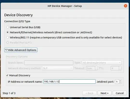

This worked for me in Ubuntu 21.04 and Ubuntu 21.10:
  1. Install these packages:
    sudo apt install hplip hplip-gui libsane-hpaio
  2. Run hp-setup
  3. Choose "Network/Ethernet/Wireless", click "Show Advanced Options", and tick "Manual Discovery". Enter the IP address of the printer. (I found it couldn't find the printer automatically, but did add it once I entered the correct IP address.)
    Screenshot
  4. Click "Next" and finish the wizard.
It should now be possible to both print and scan.
