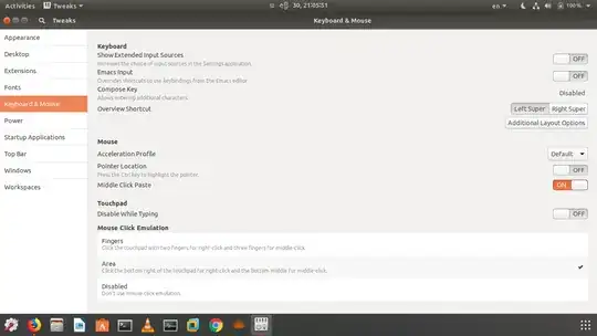

Install and open gnome-tweak and go to Keybord & Mouse >>> mouse click emulation and just click on Area and close the window.
