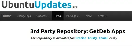

According to ubuntuupdates.org there is no repo for bionic, hence your error message.
