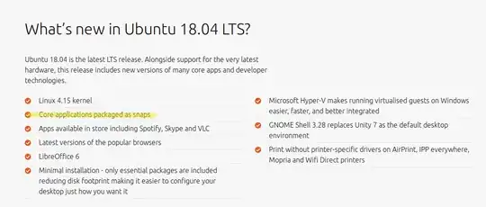

Ubuntu is using snaps, shown below
Core applications packaged as snaps
Shown here
So, my question is, that since snaps are shown using the df command, and they apparently flood df.
It's just flooding df, and makes it harder to use. Is there a way to stop it? I'm assuming since snap is planning on being used more frequently it will either no show in df, or df will become a much longer command with more pipes.
