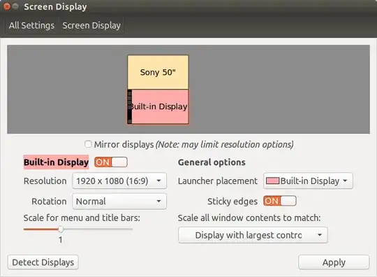

Check your monitor positions they may have changed and your mouse isn't going following the same path it used to. Go into Settings -> Screen Display and you'll see this:
Screen Display
If monitors are above/below you have to move your mouse up and down. If monitors are left/right you have to move your mouse off the left edge to the right and vice versa.
If this is not the behavior you desire then left click on one monitor and drag it to the appropriate position in relation to the other(s).
