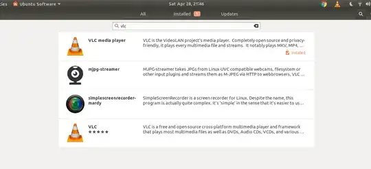

datashaman
  • 133
I removed every trace of VLC
sudo apt remove '^vlc'
Then opened Ubuntu Software, searched "Vlc", then selected the first option.
Not sure what's going on there, but there are 2 VLC in the application store.
Doing sudo apt install vlc seems to install the second VLC in the list (with stars) which doesn't work.
But the first one works, yet has no ratings.
