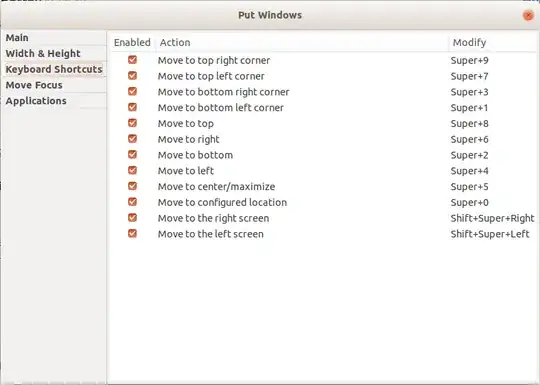

Here's the instructions on how to install the Gnome Extension "Put Windows", which will give you the keyboard shortcuts you are looking for to replicate the window arrangements you want. You can snap windows to the top-right, top-left, bottom-right, bottom-left, top, bottom, left, right, or center. Repeated presses of the shrotcuts even can toggle different size arrangements of many of those.
Follow the instructions here: How can I snap a window in a corner with 18.04?
UNFORTUNATELY, it seems this extension does not enable the drag-to-corner feature to make it snap to the corner. Rather, you are left only with Gnome's default drag window to the left to snap left, and drag window to the right to snap right. Dragging to the corners will NOT make them snap to the corner. You must use the keyboard shortcut for that. IF ANYONE FINDS A WORK-AROUND TO MAKE DRAG-AND-SNAP-TO-CORNER ACTIONS POSSIBLE, PLEASE LET ME KNOW.
Here's a screenshot of the Put Windows shortcut configuration page, copied from my answer I wrote at the link above. enter image description here
