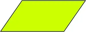

Do you mean skewed—as in, stretched in some way, like this:
parallelogram
—or rotated?
I'm assuming you mean rotated, since I honestly don't think it's possible for your scanner to mess the image up that badly!
