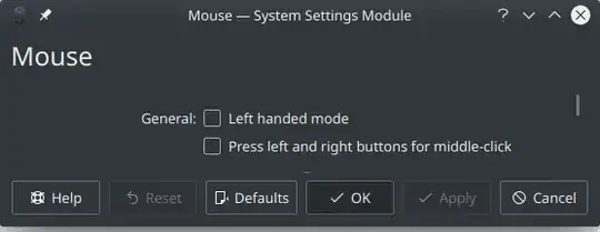

I did tried to follow above answers but my external mouse was also not working to set the options.
So, I opened Mouse Controls and Checked and Unchecked the Left handed mouse option.
Restarted the laptop and it started working.
