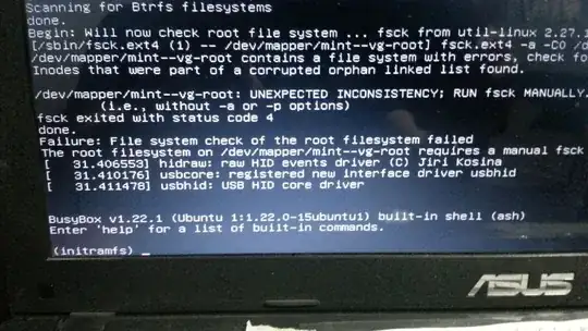

Short while after installation and kernel update I get this Error & unable to access desktop.
Unexpected Inconsistency

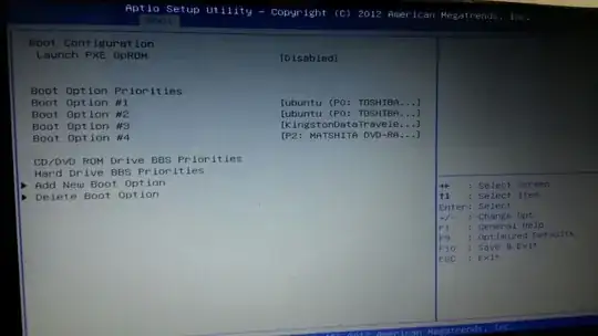

In System setup - there's no option to prioritize Boot device as usual.
Boot from HD only
My question is: How should I access desktop or restore the boot prioritize ability?

To check/repair the file system on your Ubuntu partition...
  • boot to the GRUB menu
  • choose Advanced Options
  • choose Recovery mode
  • choose Root access
  • at the # prompt, type sudo fsck -f /dev/mapper/mint--vg-root or sudo fsck -f /
  • repeat the fsck command if there were errors
  • type reboot
If for some reason you can't do the above...
  • boot to a Ubuntu Live DVD/USB
  • start gparted and determine which /dev/sdaX is your Ubuntu EXT4 partition
  • quit gparted
  • open a terminal window
  • type sudo fsck -f /dev/mapper/mint--vg-root or sudo fsck -f /dev/sdaX # replacing X with the number you found earlier
  • type reboot
