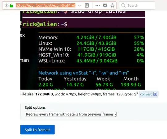

This website lets you upload your .gif and analyzes it many ways including the number of frames in it:
