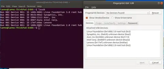

I tried using lsusb, but it didn't show the fingerprint device.

First, check if you can see your fingerprint device with the next command:
lsusb
Second, You need to install fingerprint-gui use the next commands:
sudo add-apt-repository ppa:fingerprint/fingerprint-gui
sudo apt update
sudo apt install libbsapi policykit-1-fingerprint-gui fingerprint-gui
Third, Logout & Login again, launch the Fingerprint GUI and enrol your fingerprints.
