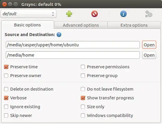

Grsync
Rsync is a little bit scary like dd, a little ignorance can go a long way. Grsync adds a GUI to rsync to make it a little less scary. I usually use Grsync when working with home directories.
