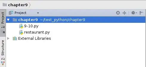

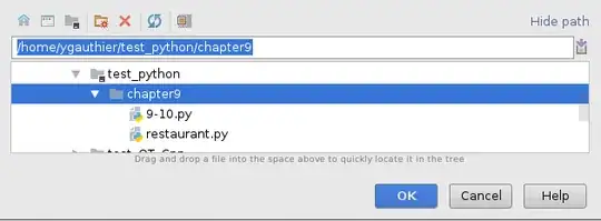

You need to open the whole chapter9 folder in pycharm. In Pycharm do : File > Open and choose chapter9 folder.
Projet folder appears in left side of Pycharm

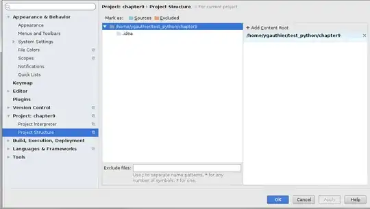

To finish you can check python interpreter and root directory. Go in File > Settings > Project: Chapter9.
  • Project Interpreter must be valid.
  • Project Structure must have a valid content root (chapter9 folder)
