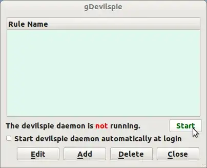

3) Start the daemon:

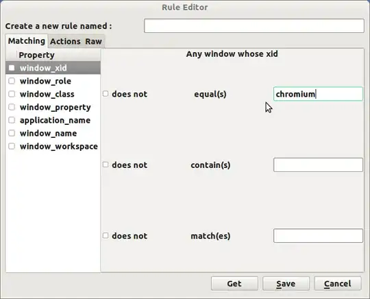

4) Select the matching window:

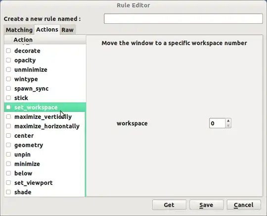

5) Choose the workspace:
