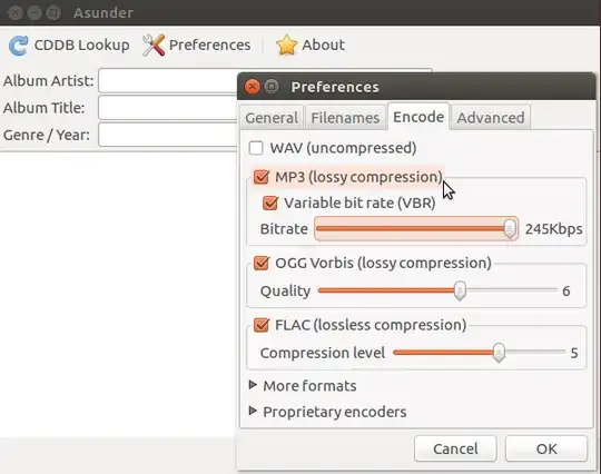

and then Asunder will automagically pick up the lame package and all will be well :) See the relevant section of the preferences in Asunder below after a successful installation of lame as well as Asunder:
Note: Asunder will encode to several other formats so consider installing the required encoders for AAC, Opus, Musepack and Monkey's Audio as well...
