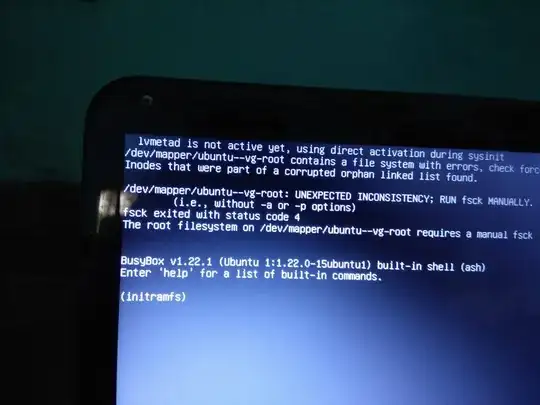

Each time I logged in to the system, intrafms screen arises asking to face mannualy. .if this problem has any permanent solution, kindly help me out of it..
When I run fsck mannually and entering into reboot ,the following screen arises.!!
This picture shows the error message.

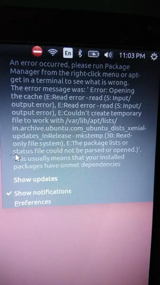

It doesn't allow to install any app,update,upgrade .....Even no files are transfer between usb flash drive and laptop. Even the driveer is not showing in laptop.

To explain a bit the output you are seeing here: If your system is still able to boot, but detects errors on your hard drive, it will eventually drop you into a busybox recovery shell. As you noticed you can run various system commands here and sometimes recover from errors. The "V1.22.1" is not an error code but just the version number of the busybox program. "initramfs" is the part of the operating system that contains the busybox recovery shell.
The real error you are facing here is printed a bit before: fsck detected unexpected inconsistencies and failed to fix them. This, in many cases, means that your hard disk is not working correctly anymore.
