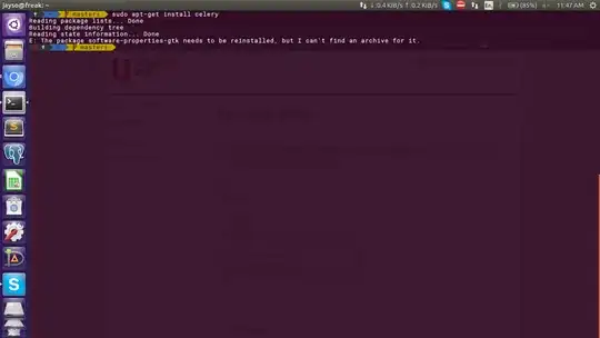

I'm using ubuntu 16.04. Whenever I tried to install new package,
"The package software-properties-gtk needs to be reinstalled, but I can't find an archive for it."
this error is occurred:
Thanks.

What you can do is sudo dpkg --remove --force-all software-properties-gtk That's happened cause the software-properties-gtk was not installed correctly and you probably deleted it's archive.
