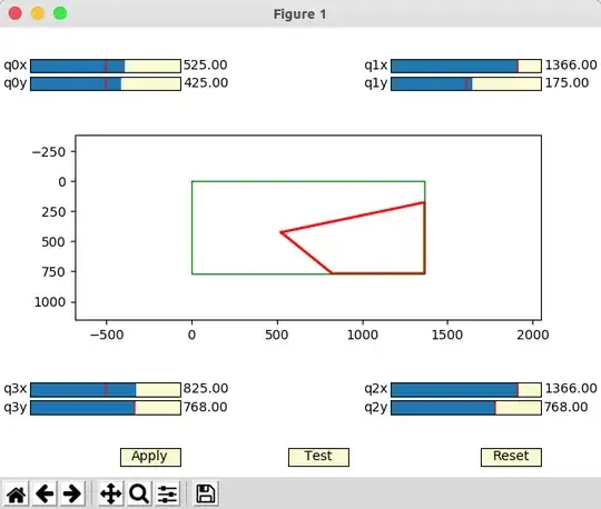

This is a graphical helper to find the xrandr --tranform parameters.
