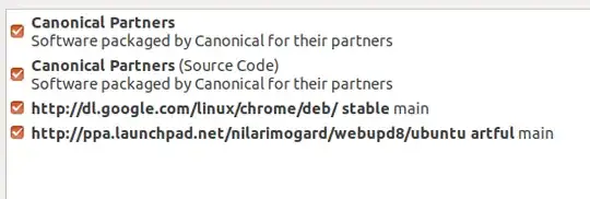

Here is my sources:
Thanks in advance for your help
