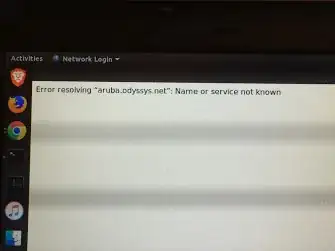

Today April 18 I tried a completely different laptop and I'm still getting the same hangup. The message says:
 Error resolving "aruba.odyssys.net": Name or service not known.

error resolving message
When attempting to connect in a browser this is the url it redirects to and hangs https://aruba.odyssys.net/cgi-bin/login.

The problem in my case is that Ubuntu does not know how to access https://aruba.odyssys.net/cgi-bin/login. The host aruba.odyssys.net is the WIFI router.
The Work Around
  • Find the IP address of that router and add it to /etc/hosts.
  • In some situations you might need to also add a line to /etc/resolv.conf.
Detailed Steps
  1. Find the router ip - in a terminal run:
    ip route
    (Example output: default via 172.31.98.1)
  2. Edit the file by running sudo nano /etc/hosts to add the line:
    172.31.98.1 aruba.odyssys.net
  3. Optional? sudo nano /etc/resolv.conf to add the line before any other nameserver entries:
    nameserver 172.31.98.1
After that the connection goes through without a hitch.
