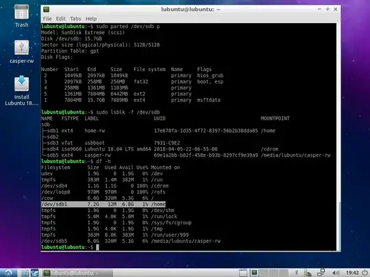

I agree with C.S.Cameron, and I will add some details and links.
Steps to more space for persistence:
  • Create a home-rw persistence file up to 4GB and move your current home from casper-rw to this partition in your current persistent live system.
    • Boot from another drive (or the same one, but live-only without the boot option persistent).
    • Create directories to become mountpoints.
    • Mount casper-rw and home-rw, for example to the mountpoints /media/casper-rw and /media/home-rw.
    • Then you can use rsync to copy /home like so (first a dry run, then remove the n and do the job),
      sudo rsync -Havn /media/casper-rw/upper/home/ /media/home-rw  # dry run
      sudo rsync -Hav /media/casper-rw/upper/home/ /media/home-rw   # do the job
      The trailing slash in .../upper/home/ is important, see man rsync.
    • When you have checked that persistence is working from home-rw, you can remove the /media/casper-rw/upper/home directory tree.
  • Create a new persistent live system with a partition labeled casper-rw for persistence (and if you wish also a partition labeled home-rw.
    See these links: mkusb and mkusb/persistent
