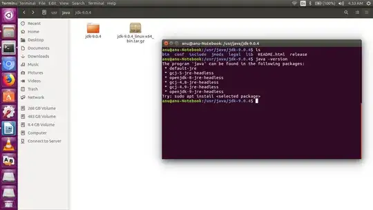

I need Oracle JDK and JRE so i downloaded tar.gz from Oracle downloads page Extracted using tar zxvf jdk-9.0.4_linux-x64_bin.tar.gz as described here https://docs.oracle.com/javase/9/install/installation-jdk-and-jre-linux-platforms.htm#JSJIG-GUID-ADC9C14A-5F51-4C32-802C-9639A947317F
But when i type java -version i am getting this error:
image here
  1. Why its not working, what are the actual steps to install Oracle jdk9 properly as above steps are not working
  2. I also want jdk and jre(Oracle only) both installed via tar and accessed with java -version and JAVA_HOME set.
  3. As you can see I cd into jdk -> bin and typed java -version but its not working, I wonder why is that? this is where actual binaries lives.

Java is one of the many commands which can be installed to / configured (selected) in /etc/alternatives/
Java 9 example
$ sudo update-alternatives --install /usr/bin/java java /usr/java/jdk-9.0.4/bin/java 1
$ sudo update-alternatives --install /usr/bin/javac javac /usr/java/jdk-9.0.4/bin/javac 2
If more than one version, please select with :
$ sudo update-alternatives --config java
