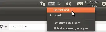

The behaviour you're describing was removed quite some time ago. It was another application (can't remember the name) that dealt with keyboard layouts then. (At least I remember something like that, I'm not quite sure now come to think of it)
What i did to get the above screen shot was go to Keyboard-Layouts, select add, Hebrew/Israel and add it to the list. My system has been upgraded since 9.10, so it should be the same on nearly every Ubuntu installation.

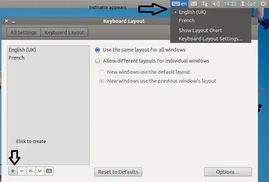

Ubuntu 12.04
The keyboard indicator appears when you have more than one keyboard layout defined.
screenshot
The country is displayed using the 2-letter code
for example - france:
screenshot
how-to

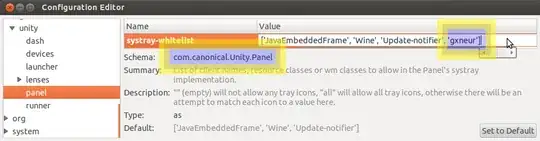

If you want the country flag to be displayed instead of the keyboard indicator, you can use a small applet called gxneur.
screenshot
gxneur
To do this, we need to whitelist gxneur. Use dconf-editor:
dconf-tools
screenshot
  • Add gxneur as shown.
  • Logout and login.
  • Start gxNeur from Dash.
  • This will display the applet.
  • Right-click the displayed applet, choose Keyboard Properties and select the Properties tab. Ensure the Auto Startup checkbox is ticked.
  • Next you need to disable the standard keyboard-indicator. Follow the instructions in this Q&A to achieve this.

Ubuntu 10.10
It only displays if you have more than one keyboard layout configured.
Go into System > Preferences > Keyboard
On the Layouts tab, add another keyboard layout and then notice how the icon appears in the notification area.
In other words, you do not get the applet if you have only one keyboard layout to choose from.

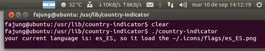

I found a python scrypt here: ubuntu App Developer: Application indicators to do an indicator App, and I tweak it a bit and did a litle Lang flag indicator.
country-indicator.py
#!/usr/bin/env python
# Copyright 2009 Canonical Ltd.
# Authors: Neil Jagdish Patel <neil.patel@canonical.com>
#          Jono Bacon <jono@ubuntu.com>
# This program is free software: you can redistribute it and/or modify it
# under the terms of either or both of the following licenses:
# 1) the GNU Lesser General Public License version 3, as published by the
# Free Software Foundation; and/or
# 2) the GNU Lesser General Public License version 2.1, as published by
# the Free Software Foundation.
# This program is distributed in the hope that it will be useful, but
# WITHOUT ANY WARRANTY; without even the implied warranties of
# MERCHANTABILITY, SATISFACTORY QUALITY or FITNESS FOR A PARTICULAR
# PURPOSE.  See the applicable version of the GNU Lesser General Public
# License for more details.
# You should have received a copy of both the GNU Lesser General Public
# License version 3 and version 2.1 along with this program.  If not, see
# <http://www.gnu.org/licenses/>
import gtk
import appindicator
import getpass
import locale
lang = locale.getdefaultlocale()
user = getpass.getuser()
png = '/home/' + user + '/.icons/flags/' + lang[0] + '.png'
def menuitem_response(w):
  gtk.main_quit()
if __name__ == "__main__":
  ind = appindicator.Indicator ("lang-flag-indicator", png, appindicator.CATEGORY_APPLICATION_STATUS)
  ind.set_status (appindicator.STATUS_ACTIVE)
  print "your current language is: %s, so it load the ~/.icons/flags/%s.png" % (lang[0], lang[0])
  # create a menu
  menu = gtk.Menu()
  mnuQuit = gtk.MenuItem("Exit")
  menu.append(mnuQuit)
  mnuQuit.connect("activate", menuitem_response)
  mnuQuit.show()
  ind.set_menu(menu)
  gtk.main()
it could be easily run as Python scrypt or be compiled with the pyinstaller
hope this helps
