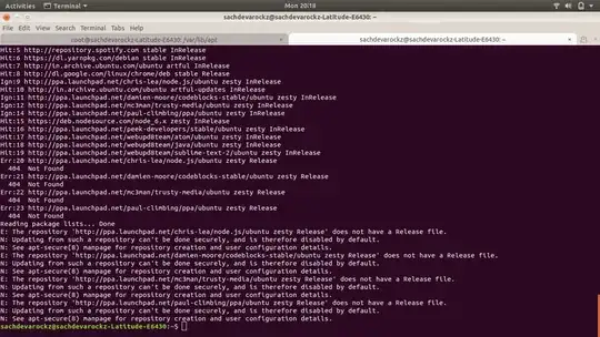

I was facing these issues in Ubuntu 17.04 :-
  • Software updater missing
  • Ubuntu store missing
  • apt-get update not working
so I updated to Ubuntu 17.10 but now facing same issues and one addition is dock settings not visible. Any help will be appreciated. thanks.
Output of apt-get update:
pomsky
  • 70,557
Any apt-get install will route to source list file so in order to install the necessary update from the default Ubuntu source site kindly update the source list, which will help to most resolve installation problems
