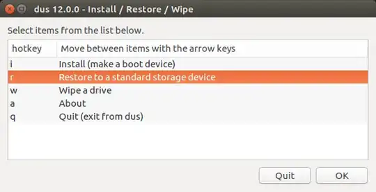

As long as you boot from this drive, you cannot change it. But if you boot from another drive you can create a new partition table and file system (alias 'format' it alias 'restore it to a standard storage device').
In Ubuntu
If you have an installed Ubuntu 16.04 LTS system, you can use mkusb-dus to restore it to a standard storage device. See the following links,
help.ubuntu.com/community/mkusb/
sudo add-apt-repository universe  # only for live standard Ubuntu
sudo add-apt-repository ppa:mkusb/ppa  # and press Enter
sudo apt-get update
sudo apt-get install mkusb mkusb-nox usb-pack-efi
help.ubuntu.com/community/mkusb/wipe
