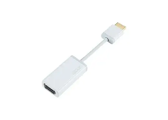

I checked the website for the HDMI to VGA converter you purchased and didn't get a good feeling at level of support. You might want to consider purchasing this Acer HDMI to VGA adapter instead:
acer hdmi to vga adapter
You can try asking Acer before purchase purchase if it works with Linux. After purchase you have two possible support channels:
  • From reputable manufacturer: Acer
  • From reputable retailer: CDW
Of course you can always get support from forums where you are more likely to find other Acer users rather than AUKEY users.
