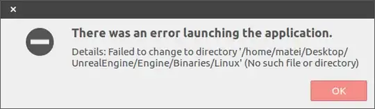

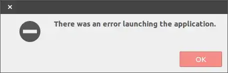

I work in Ubuntu 16.04 LTS and I have Unreal Engine installed. As you know, UE is only for MacOS and Windows, so I had to use the source code from Github. I installed it, but if I move the UE folder from Desktop to Downloads and try to run the shortcut, it says that it couldn't(even if I modify the UE's folder's location from Properties). Because I hate putting too much shortcuts/files on Desktop, I want to hide the file for UE. Do you think if I hide the folder,the shortcut will work? If yes, can you tell me how to hide it?
The UE's folder is on the Desktop. If I move it anywhere on the PC and change the path in the shortcut:
OR
So, what should I do?
