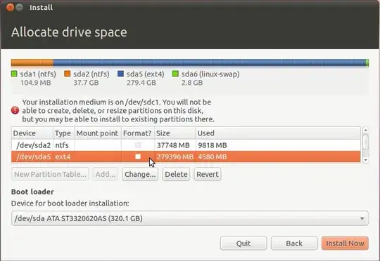

You need to select a root file system in the advanced partition editor, select your hard drive where you want Ubuntu and set the mount point to /. enter image description here
