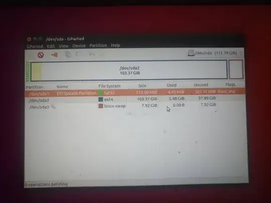

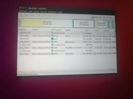

I've wiped my SSD, created all the necessary partitions. See screenshots.
SSD partition
ssd partitions
HDD partition
hdd partitions

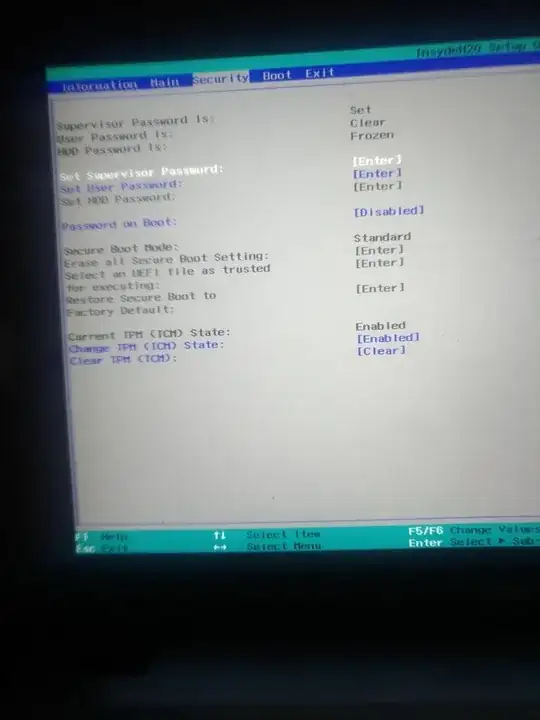

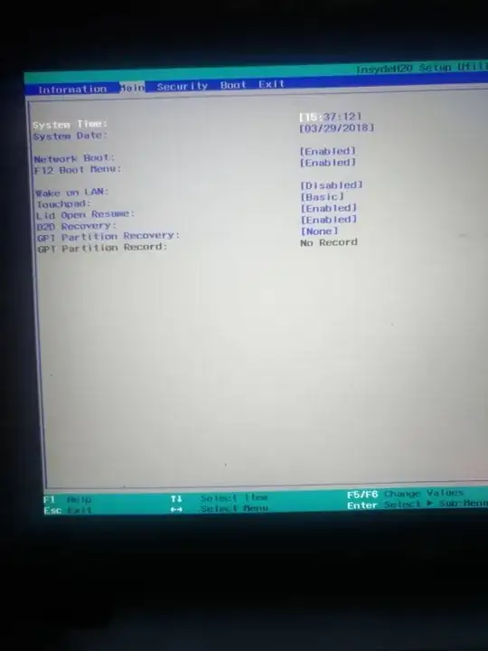

The problem is that my laptop doesn't recognize any of these drives as bootable.
Here are the BIOS screenshots.
bios1
bios2
bios3

Solved. I found this Acer Aspire E15 will not dual boot solution for acer e15 but mine was acer v15, then i remembered my motherboard was replaced a year ago. So the solution worked.
