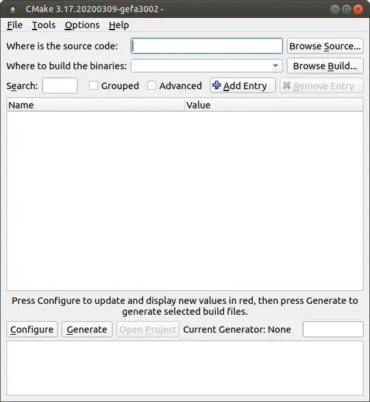

Type cmake-gui to start the UI
A screenshot of cmake-gui
Cool!
