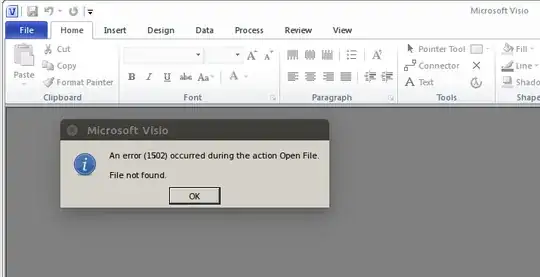

When opening a vsdx file, it fails with the error message:
An error (1502) has occurred during the action Open File. Fine not found.
I am not sure if the issue is with the Visio Compatibility Pack install or with some setting changes I made somewhere earlier during trial and error.

It looks like the Viseo 2010 Compatibility Pack is not working through Wine - the compatibility report on the Crossover website (a product based on Wine) indicate that it will install but it won't run.
https://www.codeweavers.com/compatibility/crossover/microsoft-visio-2010-compatibility-pack
Since Crossover is geared toward better MS Office compatibility over regular Wine, and it won't run on Crossover, I'm certain it will be the same case with Wine itself.
