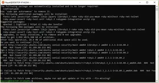

The ruby error is enter image description here

Since you don't provide exact command that lead to this state, I can only think of a few possibilities:
  1. You did not run this with root privileges (you need special privileges to access mentioned path /var/lib/dpkg and /var/lib/dokg/lock) - you can fix this by adding sudo before your command (like sudo any commands you wish and entering your accounts password when prompted.
  2. Another program is currently accessing aforementioned directory (like opened package manager). You can just close it and thus unlock it.
Next time, please provide command that led to your behavior and Ubuntu version for good measure.
