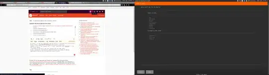

However, after I run conjure-up and click OpenStack with NovaLXD, I saw the screen below:
"Choose a cloud" dialog
All options are gray so I cannot choose any of them.

You should install and initiate LXD.
Run these commands as described in this documentation for conjure up:
sudo snap install lxd
/snap/bin/lxd init
The localhost option will be green in the Configure a cloud section when LXD was initiated
