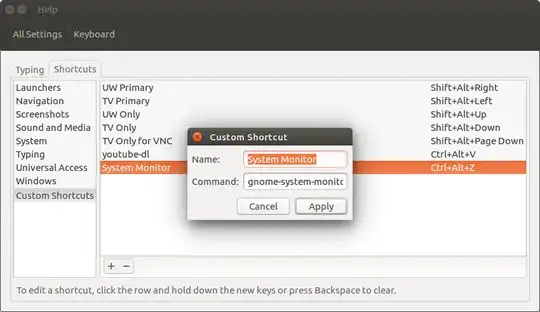

For some reason my custom shortcut for the System Monitor that I created according to this instruction does not work. Is there a default shortcut for System Monitor?
When I press it, it just does nothing. Any ideas?
My shortcut is ctrl+shift+esc.
Here is a screenshot:
screenshot

For some reason there is a problem using Esc key within Custom shortcuts. Here is the same (unanswered) question: Ubuntu 16.04 escape key doesn't work in custom keyboard shortcut. I found also this question: Keyboard shortcut Shift + Ctrl + Escape does not work, where in the comments @Cas says: I have opened a bug report: #1350527.
Мy suggestion is to use another key combination, for example Ctrl+Alt+Z, and command to be executed: gnome-system-monitor.
