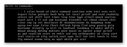

But fsck command not available. Available Commands are:
Available Commands

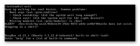

The error is:
Error

This issue is caused by the UUID in the /etc/fstab file not matching the UUID of the disk itself. DigitalOcean Support team have set my Droplet to boot to recovery mode. Then I power off and on the Droplet from the control panel. From the recovery mode, I mounted my droplets disk. I viewed the correct UUID with the command "blkid" and then edit the /mnt/etc/fstab file after mounting my disk to correct this. Then I power off and on the Droplet from the control panel once again. DigitalOcean Support team set the Droplet to boot normally. Then droplet worked very well.
