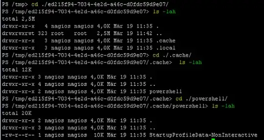

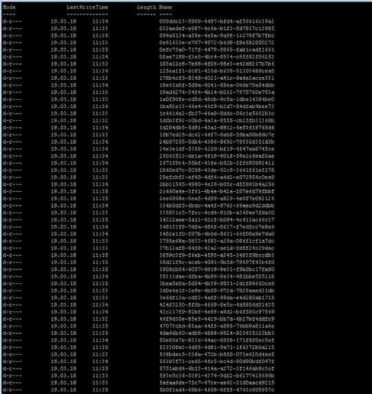

When a powershell-script is run (on the beforementioned server) by the nagios service (in the context of the user "nagios") the powershell-instance creates a directory in /tmp but never deletes it. This results in the filesystem running out of INodes after about 2.5 days. With ps -ef I can see that the following command is executed by nagios: /usr/bin/pwsh -noni -nop -nol -ep Unrestricted /usr/local/nagios/libexec/[script name].ps1 [command line parameters] (I replaced the concrete names and arguments for the script because they contain sensitive data).
See result of dir -Directory in Powershell
@See result of <code>dir -Directory</code> in Powershell
See Content of example temporary directory
@See Content of example temporary directory
I think the Directory-names are the host-instance-ids like in Get-Host in powershell.
