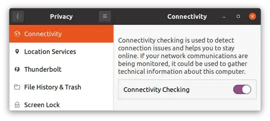

I just found another method that works for me:
Enable Connectivity Checking in Settings. enter image description here
This will pull up the captive portal at Starbucks. (Read this somewhere on SO but now can't find the page anymore)
