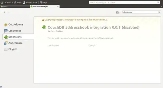

I must admit I couldn't get it to work myself but after a bit of digging around I found that CouchDB address book intergration is not compatible with Thunderbird 9.0, unfortunately that's why you get no option to select Ubuntu One as a directory server - it relies on CouchDB!!
See below screenshot
