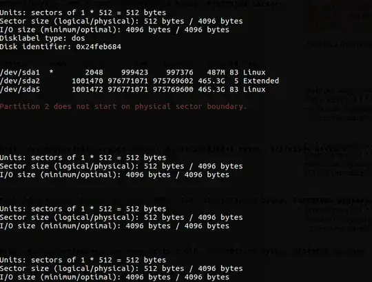

When I do
$ sudo fdisk -l
it shows the following:
screenshot
Please help me out how to recover data using extundelete

sda is the whole drive, you should use sda5 as this appears to be your OS-partition. So if you modify your command to
sudo extundelete --restore-all --after $(date -d "-2 hours" +%s) /dev/sda5
it should work as you expect.

It looks like you're trying to use extundelete on a mounted partition. Rather, you should use a Ubuntu Live DVD or USB to boot, install extundelete in the live system, and then use it on the unmounted /dev/sda5 partition.
You'll also need some other media (another USB stick will do) to restore those deleted files to.
This guide should walk you through it: The Magic of Extundelete
