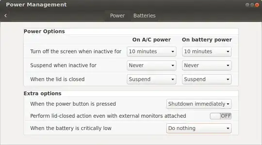

I'm using Ubuntu 17.10 with Gnome on an Asus laptop.
In the Power Settings interface, under the Power tab, there is an option at the bottom to set what to do in case the battery gets critically low.
However, when I click on the drop down to set that option, it only offers one option, which is "do nothing":
do nothing power option
Currently, my laptop will run down to 0 battery power, or close to it, and then shut off with no warnings, no possibility of closing programs and shutting down gracefully.
I would like to have a warning when the battery is at 10% and hopefully some time to manually save and shut down programs before turning the computer off. How do I achieve this?

Questioner
