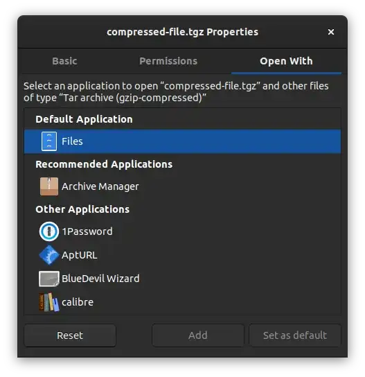

It's much easier in 18.04! (I'm not sure since when this works)
In "Open With" set the application "Files" as default and that's it.
screenshot

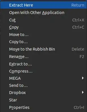

Now when you right-click on the archive, "Extract Here" is the first entry in the context-menu and will be called on doubleclick.

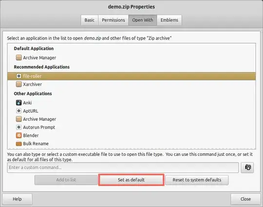

Select a *.zip file with a right mouse click and go to properties. Instead of using a mouse, you can use Alt+Enter.

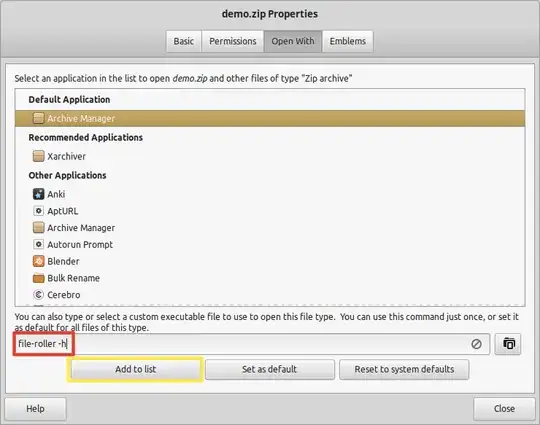

In the textbox, write file-roller -h 1. Select Add to list. In case you don't have it installed, use sudo apt install file-roller -y.
Then select file-roller and Set as default.
Now, file-roller is set as default. You can close the properties window. Now when you open a zip, it will be automatically decompressed for you. To do the same for *.tar.gz files (application/x-compressed-tar in general), skip adding file-roller to list as it's already there - only set as default.
