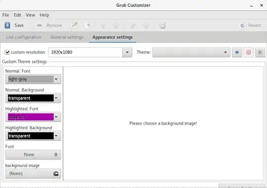

You can edit GRUB to set a custom resolution to fix this. If I remember correctly the splash screen will also be the correct resolution then.
Because editing the GRUB has potential consequences and terminals are scary I like to use a GUI for this.
Add the PPA and install Grub-Customizer
sudo add-apt-repository ppa:danielrichter2007/grub-customizer
sudo apt-get update
sudo apt-get install grub-customizer
Inside Grub Customizer, set the cutom resolution and save. grub customizer
