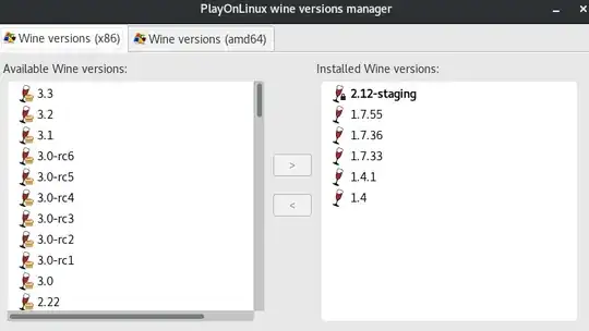

PlayOnLinux has a gui to control your installed Wine versions. If you open it, go to Tools > Manage Wine Versions you can then remove and add different ones.
POL Wine Manager

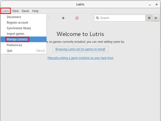

So, to manage wine versions in Lutris, go to Lutris > Manage Runners.
Lutris main window
Find Wine in the list and select Manage Versions.
Untick the Wine versions you do not want.
