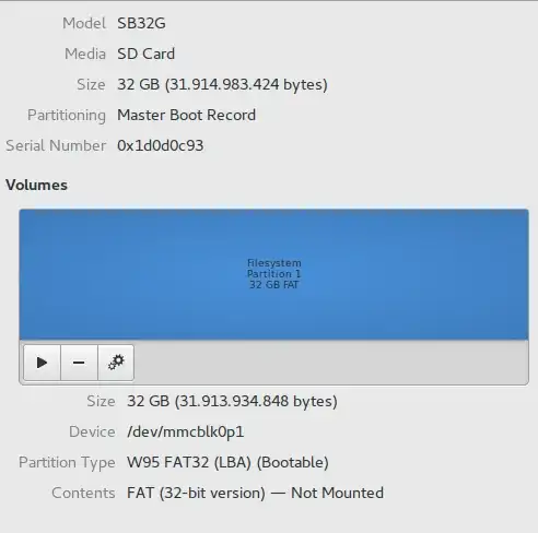

Using Ubuntu disk utility, it show the card partitioning information as "Master boot record". On the volume window, it shows as FAT.

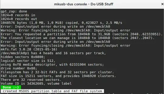

Eventually, after running sudo dd if=/dev/zero of=/dev/mmcblk0 and mkusb:
1024+0 records in
1024+0 records out
1048576 bytes (1,0 MB, 1,0 MiB) copied, 0,45646 s, 2,3 MB/s
Error: Input/output error during write on /dev/mmcblk0
Warning: Error fsyncing/closing /dev/mmcblk0: Input/output error
Error: You requested a partition from 1049kB to 31,9GB (sectors 2048..62333951).
The closest location we can manage is 1048kB to 1048kB (sectors 2047..2047).
mkfs.fat 3.0.28 (2015-05-16)
/dev/mmcblk0p1 has 64 heads and 32 sectors per track,
hidden sectors 0x0000;
logical sector size is 512,
using 0xf8 media descriptor, with 7997296 sectors;
drive number 0x80;
filesystem has 2 32-bit FATs and 8 sectors per cluster.
FAT size is 7795 sectors, and provides 997709 clusters.
There are 32 reserved sectors.
Volume ID is 39d99a2f, volume label            .
 Done :-)
 created MSDOS partition table and FAT file system
Unplug and re-plug the flash card to see the correct info ... and press Enter
Wait 5 seconds and a little more ...

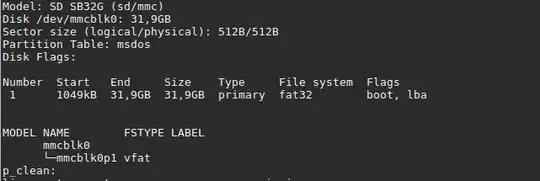

Model: SD SB32G (sd/mmc)
Disk /dev/mmcblk0: 31,9GB
Sector size (logical/physical): 512B/512B
Partition Table: msdos
Disk Flags:
Number  Start   End     Size    Type     File system  Flags
 1      1049kB  31,9GB  31,9GB  primary  fat32        boot, lba
MODEL NAME        FSTYPE LABEL
      mmcblk0
      └─mmcblk0p1 vfat

EDIT: mkusb:
mkusb log - 1
mkusb log - 2
Disk utility
When I try executing the benchmark from Disk utility, I get: Error writing 10485760 bytes at offset 0: Input/output error (g-io-error-quark, 0)
Also, I don't think those labels(boot and lda) should be there but I can't seem to be able to remove them.
