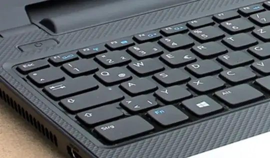

Dell Inspiron 3521 don't have a hard button to turn WiFi off/on.
Instead toggle by pressing Fn + F2:
image of the keyboard
The output of rfkill list all you provided is particularly useful to detect the problem wasn't elsewhere.
