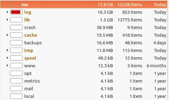

I'm on 16.04. Free disk space keeps on getting smaller by the hour in Gigabytes. I'm not downloading anything or installing anything.
Yesterday I ran timeshift, and I regained 20GB+ of free space. This morning it went again to no disk space available. I did another second system restore on timeshift & I'm monitoring the free space and it's depleting again at a fast rate.
I ran Disk usage analyzer, but I'm not sure which one is getting bloated by the minute.
I deleted files,trash and apps,but free space is not increasing,not until I do system restore.
what could be causing this?

disk usage showing /var filling up
128M    /var/lib/clamav/daily.cld
175M    /var/log/kern.log.1
351M    /var/lib/clamav
822M    /var/lib/apt
822M    /var/lib/apt/lists
1.4G    /var/lib
11G /var/log/kern.log
11G /var/log/syslog
22G /var/log
24G /var/
