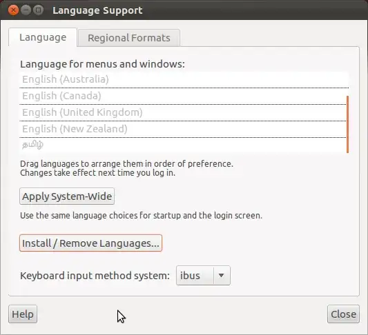

I had the same problem (Chinese showing up in lists and once even as the system language) and this command solved it:
sudo locale-gen --purge
As an extra package, it does take up some space. You can remove it by clicking on the 'Install / Remove Languages...' button.

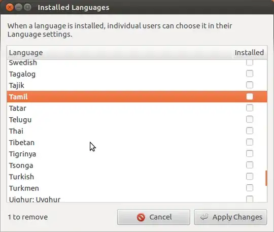

Here, note that I have Tamil installed as one of my supported languages. To remove it, click on the above-mentioned button.
Then, untick the check box next to the language. After that, click on 'Apply Changes' and you would have removed all your unwanted languages.
