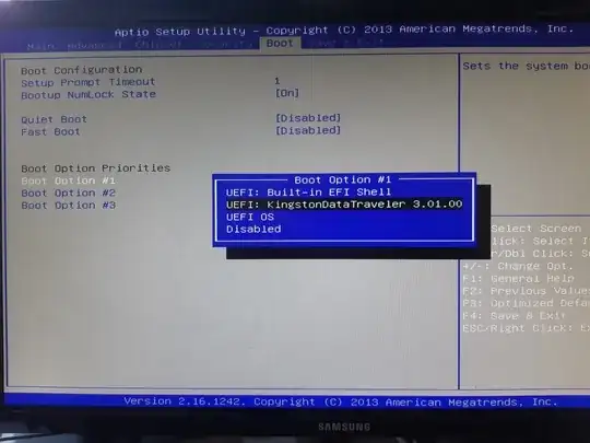

These are the boot options from BIOS: enter image description here
I assume, you have a legacy BIOS disk image. and you try to replicate to other computer with UEFI. from all the steps you've done. watch this part! sudo mount /dev/mmcblk1p1 /mnt/boot/efi before doing that, of course you have to sudo mkdir /mnt/boot/efi
sudo chroot /mnt after this, of course you have to sudo apt install -y grub-efi or sudo apt install -y grub-efi-amd64-signed
grub-install /dev/mmcblk1 don't forget to add --target=x86_64-efi or --target=i386-pc and --force and --removable (this is because you want it on removable device, right?).
It may look like this: grub-install --target=x86_64-efi --force --removable /dev/mmcblk1 or grub-install --target=i386-pc --force --removable /dev/mmcblk1
